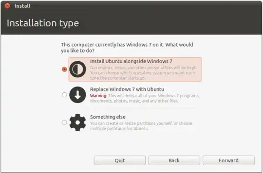

It is always a good idea to install Windows before you install Ubuntu. When you install Ubuntu and get to the Installation type screen in the Ubuntu installer, choose the option that says: Install Ubuntu alongside Windows 7. This option will install Ubuntu alongside Windows 7 in a dual boot layout so that when you start the computer you can select to boot to either Ubuntu 14.04 or Windows 7 from the GRUB boot menu.
