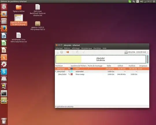

gparted :
Grab a Ubuntu LiveUSB (the bootable USB or CD/DVD you used for installing Ubuntu), use it to wipe your disk (using gparted), boot from your Windows 8.1 ISO and create partitions and then install Windows 8.1
Wiping Hardish with gparted:
  • Open gparted
  • Select your disk and click the "Create new Partition Table" option from the "Device" menu, select msdos as partition type and click apply. enter image description here
This will wipe your HDD, backup anything you want
Now you may continue with installation of Windows 8.1
