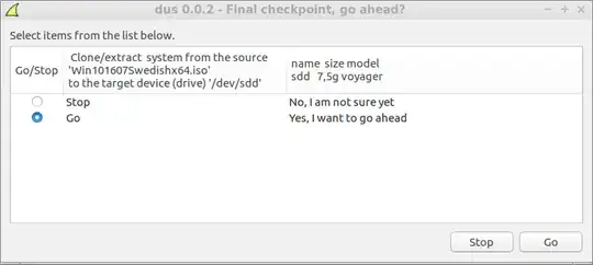

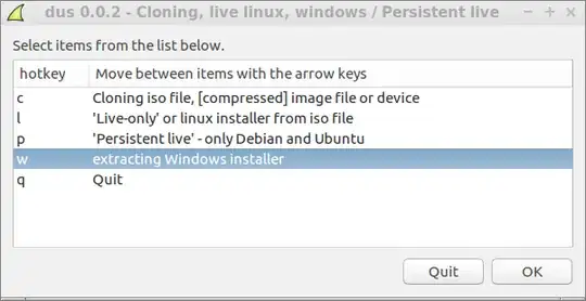

I suggest that you use mkusb-nox (in text mode) or the new guidus (with a graphical user interface). These tools can create USB install drives with Windows 7-10, and they do the same thing under the hood. See the following links,
mkusb/gui#Installation
Making a USB drive to install Windows
