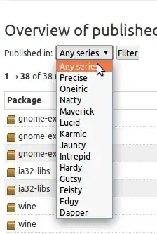

As an example of this here is an image of the versions that are supported in the Wine PPA:
Here you can see that this PPA is supported since Dinosaurs.

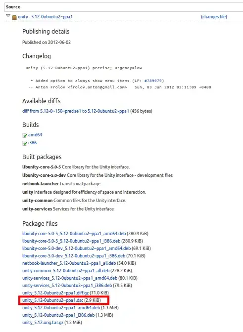

All the concerns listed by others here are extremely important to understand. That said, since this is open source, we can tell exactly what the PPA has changed from the version of the package in Ubuntu. We'll use the PPA from this duplicate as an example.
First we'll grab the source from the PPA dget a tool that will download all the pieces of a Debian source package given a link to the dsc file:
dget -u https://launchpad.net/~anton0/+archive/unity/+files/unity_5.12-0ubuntu2~ppa1.dsc

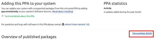

I found that link by clicking "View package details":
And then:
find dsc file
Next, we'll get the source of the package in the Ubuntu archive:
apt-get source unity
Finally, we'll use debdiff to see the differences between the source of the two packages:
debdiff unity_5.12-0ubuntu1.1.dsc unity_5.12-0ubuntu2~ppa1.dsc
The output of that command is about three hundred lines long, so I'll put it on a pastebin instead of directly into the window. Now, I can't vouch for how good the code is since I don't really know C++, but it seems to be doing what it claims and not anything malicious.
