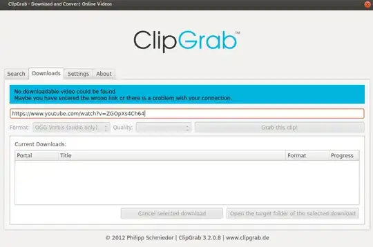

"No downloadable video could be found." error with ClipGrab version 3.2.0.8.:
ClipGrab v.3.2.0.8.: No downloadable video found error

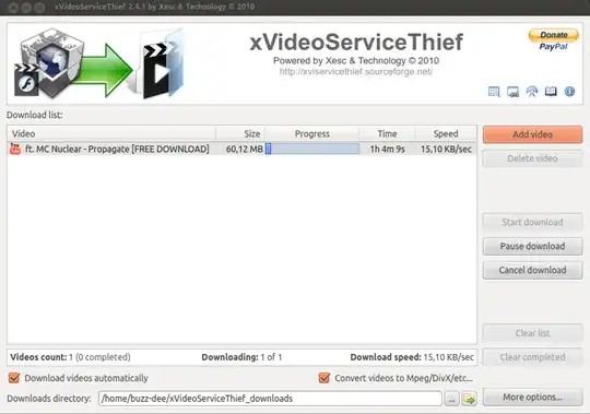

Software with similar features like ClipGrab: xVideoServiceThief
xVideoServiceThief downloading
