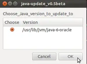

webupd8.googlecode.com hosts a nice-easy script to help with this.
wget https://storage.googleapis.com/google-code-archive-downloads/v2/code.google.com/webupd8/update-java-0.5b
chmod +x update-java-0.5b
sudo ./update-java-0.5b
don't worry - 0.5b refers to the script version - not the version of java!
An alternative to this is to use the webupd8 ppa and the update-java package.
