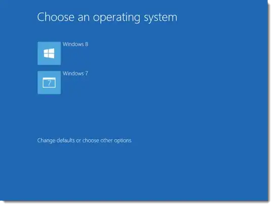

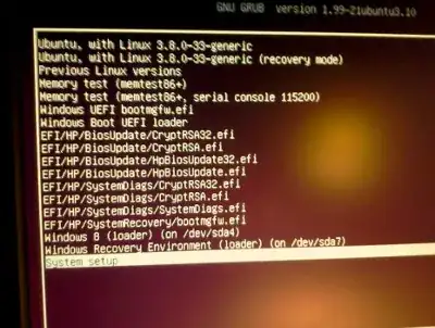

A few days ago, I've installed ubuntu 12.04, and when I load my PC, I get this menu: GRUB.
What I want is to have this menu: enter image description here
but showing the two operating systems (Windows 8 and ubuntu).
Is it possible to move to that dual-boot interface?
Thanks.

Unfortunately, it is not possible to boot Ubuntu from the second screen (showing Windows 8 and Windows 7). That bootloader will only work with Windows, not Ubuntu.
It is possible to get a nicer looking boot screen, using projects such as Burg. Be warned, however, that modifying your bootloader can potentially prevent you from booting into any operating system on your hard disk. If this happens, Boot-Repair can be used to fix some (not all) problems.
