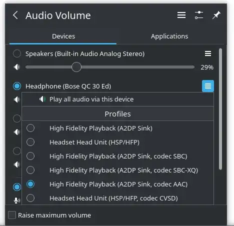

≥ 2021: with pipewire
Pipewire supports APT-X through libfreeaptx0.
To install it use the instruction of the pipewire-debian ppa, in summary:
sudo add-apt-repository ppa:pipewire-debian/pipewire-upstream
sudo apt install gstreamer1.0-pipewire libpipewire-0.3-{0,dev,modules} libspa-0.2-{bluetooth,dev,jack,modules} pipewire{,-{audio-client-libraries,pulse,media-session,bin,locales,tests}}
systemctl --user --now disable pulseaudio.{socket,service}
systemctl start --user pipewire-pulse.service
systemctl enable --user pipewire.service
systemctl --user mask pulseaudio
Pic of the additional codecs in KDE (for a device not supporting apt-X) additional codecs in KDE
