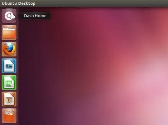

The simplest way to install Java on Ubuntu is to use OpenJDK. This will work fine for most people. To install it, click on the small button with the Ubuntu logo on it, as shown in the screenshot below.

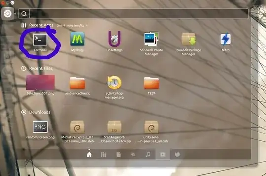

After opening the Dash Home, you need to type in Terminal. Click on the icon that is circled in the screenshot below.
This will open the Terminal, which is Ubuntu's version the the Windows Command prompt, though the Terminal has many more features. Now, copy and paste the following command into the Terminal window. You will need to use ControlShiftV to paste text into the terminal.

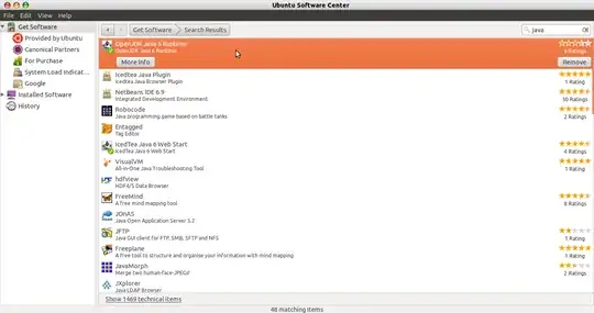

Just a side note: most of the time, with Ubuntu, you should not download software from the Internet, but rather use the Ubuntu Software Center. The software you'll find there is ensured to be stable, safe and to respect the standard conventions of the system. Oracle Java is just an exception to this rule.
Just go to Aplications --> Ubuntu software center and then search for Java. enter image description here
