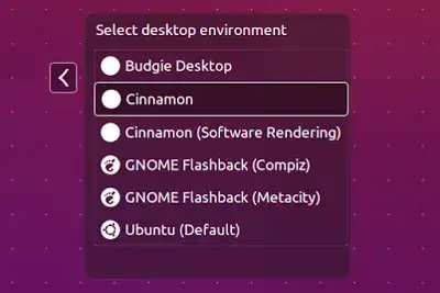

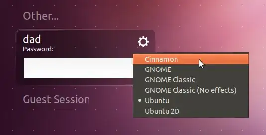

Logout and select the Cinnamon session:
Enter you password and you'll see the Cinnamon desktop

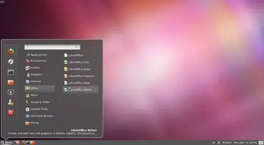

... showing the traditional start type menu and applet design from Gnome-2

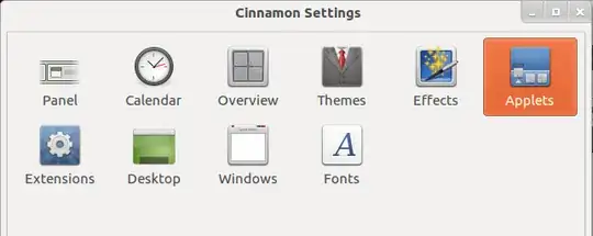

Cinnamon uses its own Settings tool.
Cinnamon Settings

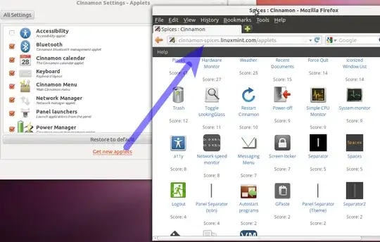

Cinnamon Applets
Similar to gnome-shell extensions - you can install applets from a dedicated Mint website.

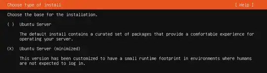

  1. You can download and install Ubuntu server
  2. Select the minimized installation and no third party driver (because it will install a server version)
minimized-install

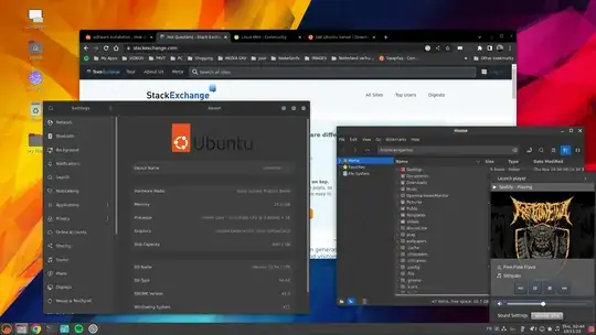

Here's a screenshot of this desktop: my cinnamon desktop

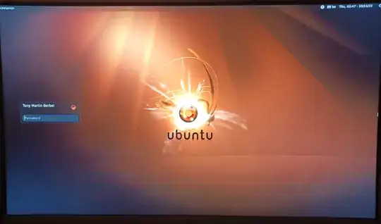

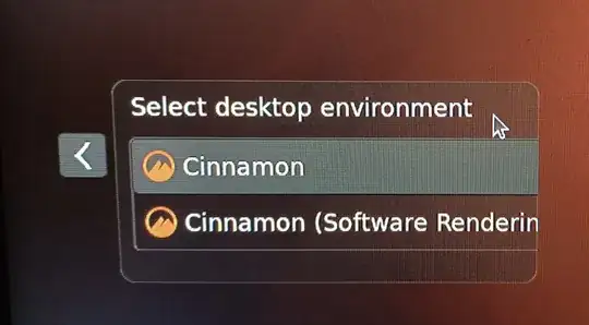

Here's the greeter: greeter
And here you can see no other environment choice as Cinnamon: select-environement

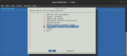

In this post you can find how to install the most recent version of Cinnamon on your server, based on the Linux Mint PPA.
I've also a made a bash script menu to solve most of the issues I've got on Ubuntu server with Cinnamon installed. It's availble on Github here.
Bash-installer-menu
