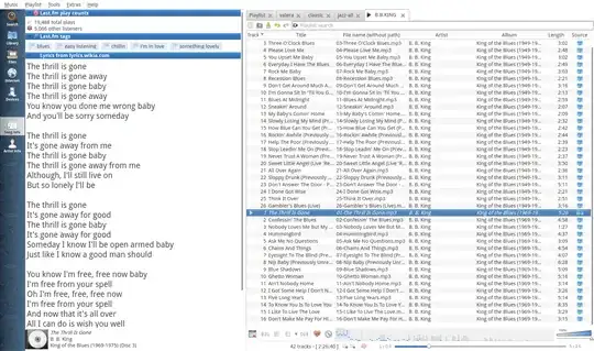

Why have a separate app for lyrics and not have them within the player? Maybe the external app like osdlyrics has a larger database? In fact it is far from matching Clementine's or that of Foobar2000 addons like Lyric Show Panel 3.
Clementine:
clementine with lyrics

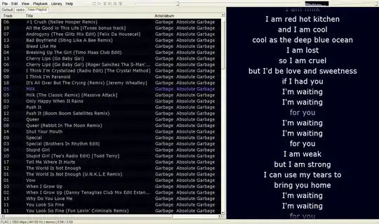

Foobar2000 in Wine/Playonlinux (excellent access to synced lyrics option to save them in tags etc):
Foobar2000 in Wine with lyrics

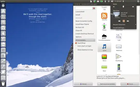

There is also a screenlet lyrics (works great with Banshee), all you need to do is to install Screenlets(widget applications):
Note: Installing software from PPA may pose a security risk.
sudo add-apt-repository ppa:screenlets/ppa
sudo apt-get update
sudo apt-get install screenlets
And then add Lyrics widget to the desktop.

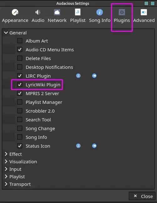

Audacious
The plugin that has to be stated is called LyricWiki.
Audacious GTK, in Settings>Plugins:

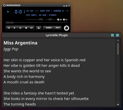

Lyrics are shown in a separate window:
The above is the GTK UI, but that window looks the same with the classic Winamp-like interface:
Once closed, that window needs to be enabled by selecting the plugin again as above.

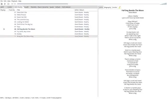

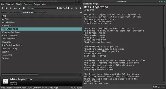

The same is true for Audacious Qt interface, but there the lyrics window can be integrated within the main one.
With the Qt UI we can increase fonts by scrolling while holding CTRL.

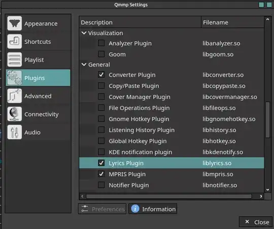

Qmmp
Similarly, the plugin needs to be enabled: Edit>Settings>Plugins>General

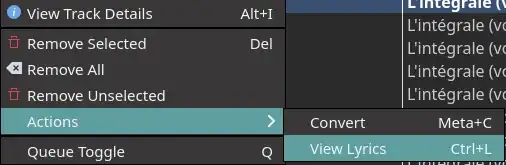

Then, select track in playlist and press CTRL-L, or: right click, Actions. Sadly, this has to be done for each track, as the lyrics window keep showing the first ones.
It seems the plugin searches before opening the window. No window opened means no lyrics available.
To increase fonts, scroll while holding CTRL.
