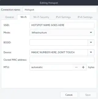

There are alternatives (e.g. create_ap) - also you can use the variety of instructions here - you could also try setting the mode to infrastructure in the 'Network Connections' settings (this may be the default with newer versions of Gnome/NetworkManager):
