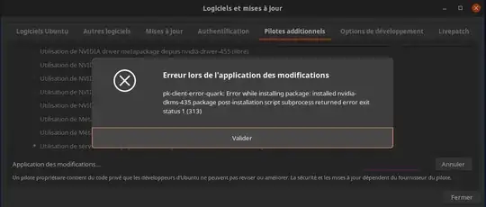

When I use the software and update application, it give me this error:
Error screenshot

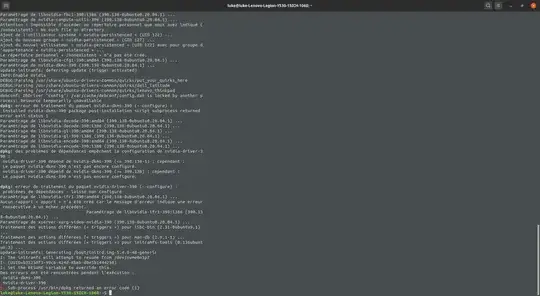

When I try to use sudo apt install nvidia-driver-xxx (I tried with every version the command ubuntu-drivers devices gave me,) it says this :
Terminal screenshot

When i try sudo ubuntu-drivers autoinstall, it gave me the same error as the second screenshot.
