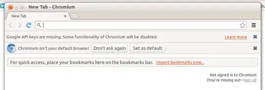

UPDATE - Remember to add the API Keys since when opening for the first time Chromium you will get this:
And basically all Google services (Like syncing for example) will not work. So follow the How To above about adding the Api-Keys. To open the profile simply type the following on the terminal:
gedit ~/.profile
And then follow what the instructions say.

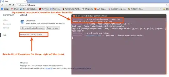

Another way, to get Chromium right off the trunk, download it from this site: https://download-chromium.appspot.com/ (this site is maintained by the Chromium team). After you finished to download, to use it run next commands in terminal:
cd /download_directory
unzip chromium.zip -d /destination_dir
cd /destination_dir/chrome-linux
./chrome --disable-setuid-sandbox
More about how to run Chromium from the unzipped folder: https://code.google.com/p/chromium/wiki/LinuxSUIDSandboxDevelopment.
Proof:
trunk Chromium
As a note, you can use this version of Chromium as a portable version on more Linux systems.

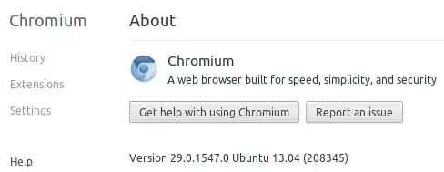

There is a chromium dev build(>= version 29.0.1547.0 at this time) available as a PPA here.
  • Installation from the command line:
    The latest dev PPA can be obtained by running the following commands from the terminal(Ctrl-Altt):
    sudo add-apt-repository ppa:saiarcot895/chromium-dev
    sudo apt-get update
    sudo apt-get install chromium-browser
