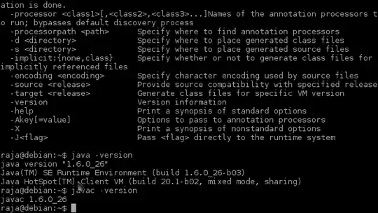

Java
java -version
javac -version
These commands display what version of java (the interpreter that runs Java programs) and javac (the compiler that creates them) you have installed.
See the image above for details.
