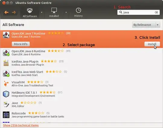

sudo gedit etc/apt/sources.list
This command is wrong. The file path should begin with "/":
sudo gedit /etc/apt/sources.list
If you need java (jre or jdk), you can install it using user827992's answer or using Ubuntu software center, typing "java" in the search box, select the package and click "Install": ubuntu software center 12.04 java jre
