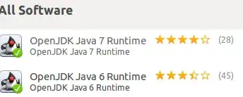

Open Software Center and type jre there.
java
