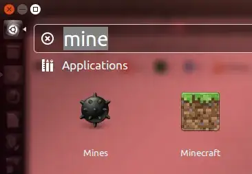

  4. Type minecraft in the Dash:
  5. Play

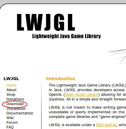

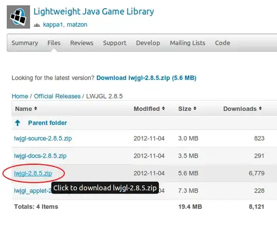

2. Download the LWJGL (Lightweight Java Game Library)
This step is STRONGLY RECOMMENDED since it will solve 99% of the problems Ubuntu users face with Minecraft. Even if you use the official Launcher or the PPA you need to do this.
Go to the following LINK to download it:
Always download the ZIP version. Don't download the SOURCE, DOCS or APPLET versions. Stick with the one with the lwjgl-VERSION.zip. For example the one I downloaded was lwjgl-2.8.5.zip
Just in case, apart from downloading the one I mentioned, also install the LWJGL version that comes with Ubuntu:

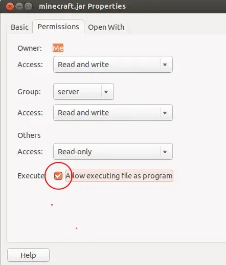

After that, open the terminal and in your home folder type chmod +x minecraft.jar. This will give the file an executable property so you can (Obviously ^^) execute the file to play the game. The file should go in your home folder since it will try to read your .minecraft folder which will also be in your home folder (I will mention how to do this later on). This step is not needed if you want to execute the file from the terminal. If you want to execute the file via GUI with Nautilus, you will need the executable bit.
You can also give the executable property by right clicking the file, going to the permissions tab and activating the "Execute" option. The one that says "Allow executing file as program".

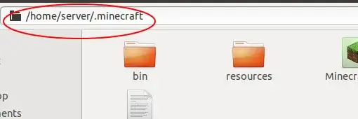

Select the .minecraft folder and copy it to your home folder. For example /home/cyrex would be my home folder, after copying it should look like /home/cyrex/.minecraft. Now, go to your home and inside your .minecraft folder. The location should look similar to this /home/cyrex/.minecraft.
In this image, since the user is SERVER, the location is /home/server/.minecraft
Since we want to go inside the .minecraft folder, you need to either press CTRL+H and in the home folder look for the .minecraft folder or press CTRL+L and add in the location bar .minecraft after the slash in /home/USER/ so it looks like /home/USER/.minecraft, then press ENTER.

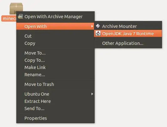

Now in Nautilus, in your home folder, select the minecraft.jar (The one that is less than 100KB in size) inside your home folder (NOT inside your .minecraft folder) and right click on it. Select open with and select the OpenJDK version you have installed.
Now PLAY!. You can also execute the game from the terminal like this:
java -jar minecraft.jar
assuming the terminal opens in your home folder (This is the default behavior).

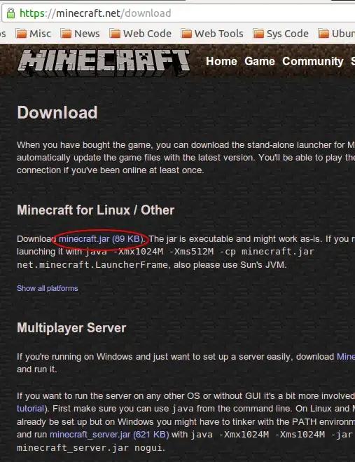

I'm assuming you already have minecraft.jar downloaded. If not, then you can get it from minecraft.net.
Minecraft is written in Java, and so if you want to run it (or any other application written in Java) you need to install the appropriate package. That package is OpenJDK Java 7 Runtime, and you can install it by opening the Ubuntu Software Centre and searching for java. It should be the first result.
When it's installed, right click on minecraft.jar, choose Open with and select OpenJDK Java 7 Runtime from the list.
B00m! You're done.

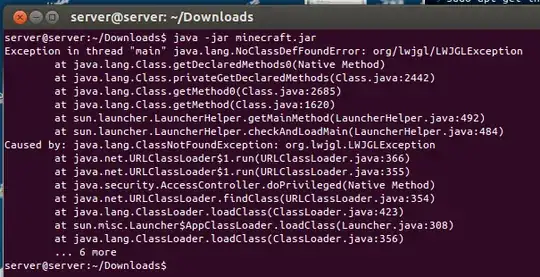

And then, since there seems to be an issue with the path to the oracle-java7 64bits library, I modified /usr/local/bin/minecraft contents to this:
#!/bin/bash
export LD_LIBRARY_PATH="/usr/lib/jvm/java-7-oracle/jre/lib/amd64"
java -jar Minecraft.jar
(source: Minecraft in jdk 1.7.0_u2 x64)
Do a backup first, and your mileage (read library path) may vary
and at this point, calling minecraft in the terminal works! (unfortunately, the Icon installed in Unity/Programs still does not work)

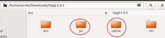

Problem is you're not finding the liblwjgl-java library you need. You may need to modify the search path to find the appropriate library.
You can see this post here: https://stackoverflow.com/questions/10063530/java-library-path-error

A simpler method, which I find works for me.
  1. Install OpenJDK 7 JRE, with this command:
    sudo apt-get install openjdk-7-jre
  2. Download Minecraft from the official website.
    1. Click the "show all platforms" link.
    2. Download 'Minecraft.jar' under the "Minecraft for Linux / Other" section.
  3. Give 'Minecraft.jar' execute permissions.
    1. Right click on 'Minecraft.jar' and open "Properties".
    2. Switch to the "Permissions" tab and then enable the box that says
  4. Run this command in a terminal:
    sudo sed -i 's:NoDisplay=true:NoDisplay=false:' '/usr/share/applications/openjdk-7-java.desktop'
  5. Ensure that the 'Minecraft.jar' file will open in Java:
    2. In the "Open With" tab, if "OpenJDK Java 7 Runtime" is not the "Default Application", click on "OpenJDK Java 7 Runtime" and then "Set as default"
  6. Double click on the 'Minecraft.jar' file. The launcher should now open.
