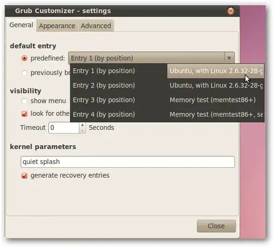

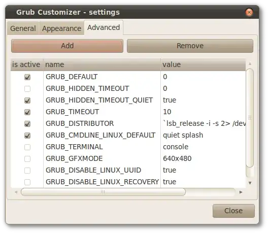

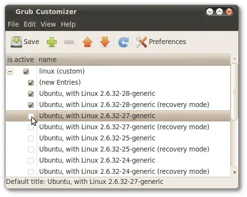

You can use an easy-to-use the GUI application called Grub Customizer to make your life a little bit easier. As the name suggests, you can do much more than just reordering GRUB menu entries with it. You can install it from a PPA in 18.04 and older releases, and from the official repositories in 20.04 and newer.
In 18.04 and older releases, add this PPA (you can skip this command on 20.04 and newer):
sudo add-apt-repository ppa:danielrichter2007/grub-customizer
And then run:
sudo apt-get update
sudo apt-get install grub-customizer
(See also this Ask Ubuntu question)
There is an How-To Geek article about it, How to Configure the Linux GRUB 2 Boot Menu the Easy Way. Take a look at it if you're interested. Also, there is a solved thread on the Ubuntu Forums, Change boot order in GRUB 2 that mentions this tool.
Here are some screenshots:
GRUB Customizer
GRUB Customizer - Settings - General
GRUB Customizer - Settings - Advanced
