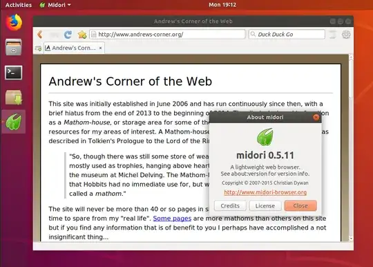

This works well enough on my Bionic Beaver VM as the following screenshot demonstrates:
Mind you this is an older and perhaps not well maintained browser so just be a little careful...
