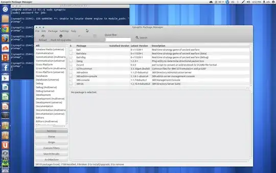

The fix is quite simple, actually. Please install Synaptic Package Manager in the Ubuntu Software Center, first. After installed, you will need to open it with root privileges:
gksu synaptic
Or else in Ubuntu 12.04 or later, you can search for synaptic in the Dash and click on the Synaptic icon to open Synaptic. You will be asked to authenticate with your user password in order to open Synaptic.
Search for Oracle-java7-installer, right click on it, and completely remove it. Apply the changes, remove the PPA, and your error messages will be gone.enter image description here
