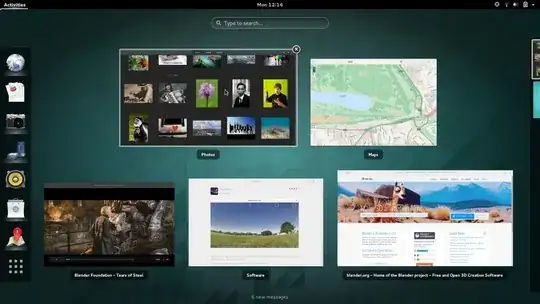

I was expecting a desktop like this:
http://www.gnome.org/wp-content/uploads/2010/09/window-selection-3.12.png

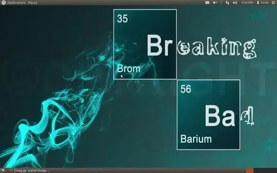

and I ended up with a desktop like this:
http://imgur.com/dWIIkeI Please tell me what I can do to get the desired desktop.

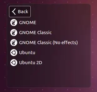

That looks like GNOME Classic. You should choose GNOME when selecting the session at login: (screenshot from the tutorial)
If you still get GNOME Classic, you can force GNOME Shell by running these commands in a terminal:
gnome-shell --replace &
disown
This will replace the current WM, send GNOME Shell to the background and detach it from the terminal so that you can close it without killing gnome-shell.

I think the first screenshot is what you get if you press the Super key, not the desktop. But it's been a while since I used Ubuntu Gnome.
