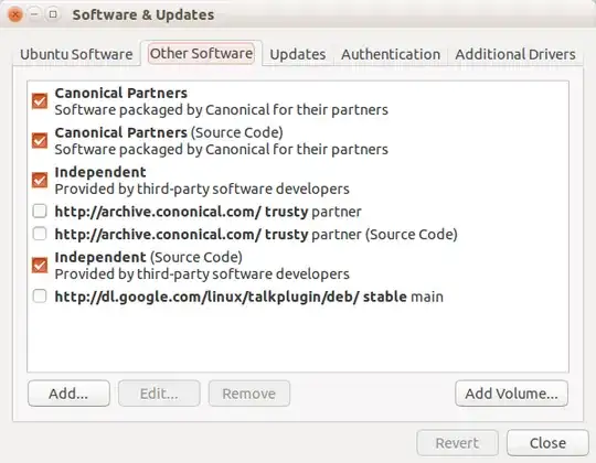

I was initially using a mobile data internet and so I was not able to update ubuntu 14.04 due to some proxy and got NO DATA when ever I did an
$ sudo apt-get install update
But then when I got a wired line and tried the same update it did not let me do it and gave the same NO DATA error.
But then surprisingly few software got installed through apt-get install statement.
I enquired all the world and got no answer. Lastly I tried this and it worked. Please check the following image.
I removed few check marks from the list in the image
I just tot it could help some one who came across similar issue.
I got this answer by installing a fresh ubuntu and tried "update" from the same wired connection and compared the settings and got it fixed :-) Re-leaved after a long pathless run.
