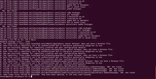

Today I have been trying to install Audacity by various methods, including the PPA repositories, the .deb file, and through the terminal using the command
sudo apt-get install audacity
and yet I have not been successful. When I tried to install audacity from the repositories it shows this
and when I tried to install it with the .deb files it just does not install and the icon showing that the program is apparently installing just stays in the Unity bar frozen until I reboot.
Could anyone help me understand what I have to do to solve this problem?

You did not add a proper ppa. As such you will keep receiving that error when you use apt. To view your list of ppas and external repositories type the following in your terminal:
ls -l /etc/apt/sources.list.d
There check for any unusal ppas something that you don't remember adding. From your output in your question, there should be a file named something like should be link here.list or link here.list. Remove these files by typing the command:
sudo rm /etc/apt/sources.list.d/<the file name>
Also, the following ppa does not have a release candidate for Xenial:
https://launchpad.net/~cdekter/+archive/ubuntu/ppa
So, you might want to remove it from the directory /etc/apt/sources.list.d
Finally, update your list, using the command:
sudo apt-get update
The errors should be gone by now.

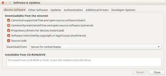

As far as the PPA is concerned you have a malformed line in your sources.lst. as whatever is generating the 404 errors either isn't a valid repository or is not reachable for some other reason and you should find and remove it. Regardless audacity is available in the universe repository so you can simply enable that in Software & Updates in order to install via sudo apt-get audacity Second from the top checkbox as shown below.
