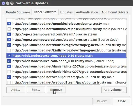

Open the Ubuntu dash and search "Software & Updates". In Software & Updates click on the "Other Software" tab and look for the PPA called "https://deb.nodesource.com/node_0.10". It should look like this:
Click on it to select it and then click remove.
