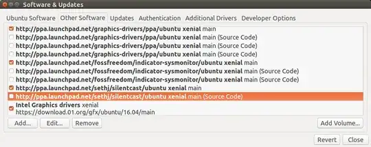

One example is a question I posted and self-answered: How can PPAs be removed using GUI?. On this screen we want to remove PPAs not upgrade the software:
After removing a PPA the GUI software automatically runs sudo apt update. If you were to remove a PPA from the command line you need to run sudo apt update after removing a PPA from sources list.
Without a separate apt update function there is no way to remove a PPA!.
