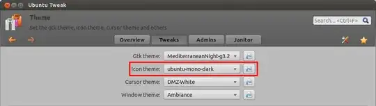

You can change icon theme with Ubuntu Tweak.
Install Faenza Icon Theme
Hit Ctrl+Alt+T to open terminal and run the following commands one by one:
sudo add-apt-repository ppa:tiheum/equinox
sudo apt-get update
sudo apt-get install faenza-icon-theme
Install Ubuntu Tweak:
After installation of Faenza run following commands in terminal to install "Ubuntu Tweak".
sudo add-apt-repository ppa:tualatrix/ppa
sudo apt-get update
sudo apt-get install ubuntu-tweak
How To Change Icon Theme With Ubuntu Tweak?
  • Once installed Hit Super key (windows key) to open Unity dash and search for "ubuntu tweak" and open it.
  • Go to tweak tab and click on "Themes" button.
  • Hare you can easily change the icon theme

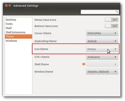

I use gnome-tweak-tool to change the icons.
Fist install faenza-icon-theme
Add the repository and update
sudo apt-get update
install
Now, install gnome-tweak-tool
sudo apt-get install gnome-tweak-tool
After Installation open Gnome-Tweak-Tool to change icons,
That's all :)

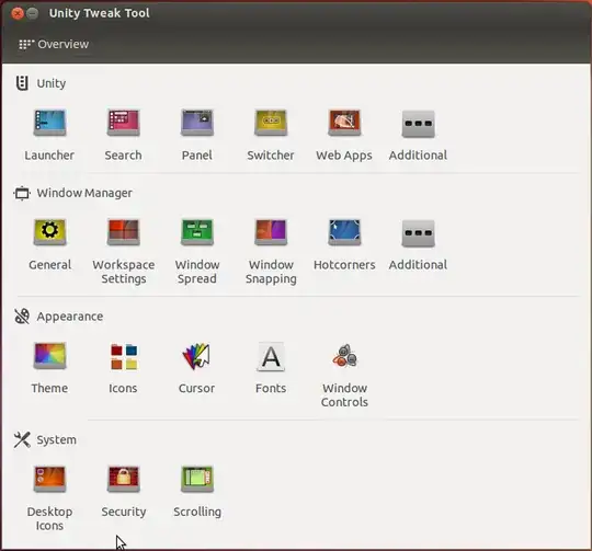

I like the Unity Tweak Tool:
sudo apt-get install unity-tweak-tool
You just have to install Faenza Icon Theme the way it became described here already:
Open a terminal (Alt+T) and run
sudo apt-get update
(More about this way of installing software via add-apt-repository and about how to remove it.)

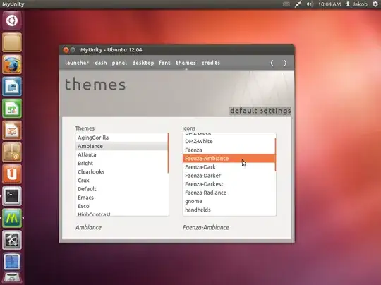

Then start MyUnity Install myuniy and switch to themes, under icons select "Faenza-Ambience" if you use Ambience as theme. Otherwise the icons in the panel don't match, which means they are black on dark background. If you prefer the Radience theme, choose "Faenza" or "Faenza-Radience". Changes should become visible immediately:
faenza and myunity
If you don't want to add a PPA as described above you can download the zip file on its homepage.

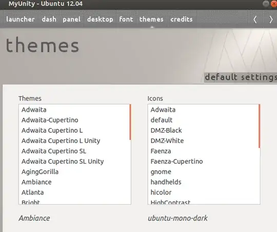

Since you have MyUnity program here are steps to change the icon theme with it:
  • Grab the the Faenza icon package/ or any other icon package. You can get more icon themes from here:
  • These packages are normally compressed so extract the compressed file to somewhere easily accessible like your desktop.
  • Copy the uncompressed folder to the .icons folder which is hidden by default in the home folder. To reveal the hidden folder, navigate to your home folder and press CTRL H
see the .icons folder in my home folder
  • Place the uncompressed folder in the .icons folder and close the folder
  • Open the dash and search for MyUnity application and launch it
  • Click on the themes tab in MyUnity and select the icon theme of your choice from the list of icon themes on the right side of the dialog box
