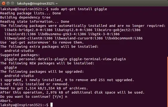

Today, when I tried installing Giggle using this,
 sudo apt-get install giggle
I am getting the following window. Trying to install Giggle
And if I press Yes, it downloads Giggle and then starts downloading the IDE all over again.

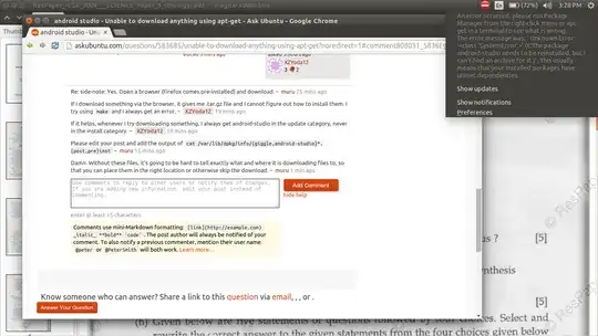

EDIT 2: I'm getting this red sign on my menu bar now. Red sign on menu bar

The main reason of your problem is the fact that, as you said, you exited before completion from the android-studio package installation. So the installation has been unsuccessful. In your case, this can be checked using the following command:
grep -A1 "Package: android-studio" /var/lib/dpkg/status
And probably the output will be something like:
Status: install reinstreq half-installed
From this output you can understand that the package android-studio has been half-installed and now a reinstallation is required.
To fix this you could simply reinstall the package or, if you don't want, then first make a backup of the dpkg status file by issuing the following command at the terminal:
sudo cp /var/lib/dpkg/status status.bak
And then open /var/lib/dpkg/status file with the following commands in terminal:
sudo -i    #  to grant access as root
gedit /var/lib/dpkg/status
When it opens, search through the file for android-studio package and delete that entry (delete everything from the line Package: android-studio until next line that starts with Package: ...). Don't delete anything else. Save the file and close it. And in terminal type Ctrl+D to logout from the root account.
Now you should be able to install any other package without the need of android-studio.
