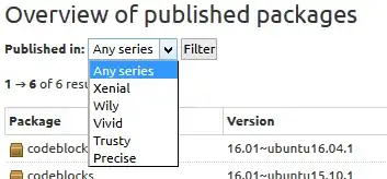

The PPA you are using is the generally recommended PPA for getting the current stable version of Code::Blocks. However, currently that PPA does not support Ubuntu 17.04.
If you go to the PPA page and scroll down to Overview of published packages, there is a Published in: drop-down menu, which shows that the PPA currently provides packages for Precise (i.e., 12.04 LTS Precise Pangolin), Trusty (i.e., 14.04 LTS Trusty Tahr), Vivid (i.e., 15.04 Vivid Vervet), Wily (i.e., 15.10 Wily Werewolf), and Xenial (i.e., 16.04 LTS Xenial Xerus).
"Published in" drop-down menu on the PPA page showing what releases the PPA provides packages for
Currently your release--17.04 Zesty Zapus--is not listed there. In the future, if Zesty appears, that means the PPA provides packages for 17.04. (It will not guaranteee that it provides all the necessary packages, though likely it will.)

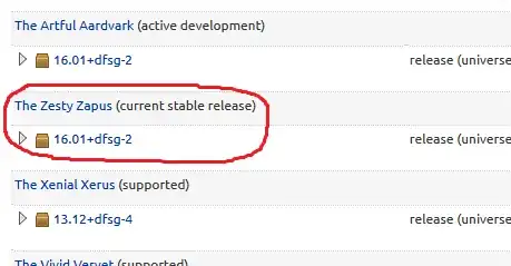

Right now the PPA provides Code::Blocks 16.01, which the Code::Blocks website confirms is currently the latest stable release. The name of the package the PPA provides is codeblocks. Searching for this package on the Ubuntu project page on Launchpad yields a search result for the versions packaged officially for Ubuntu. Clicking through brings up the source package page for codeblocks in Ubuntu, which shows the currently available versions.
Screenshot of the codeblocks in Ubuntu source package page on Launchpad showing the versions available in recent Ubuntu releases.
This reveals that 17.04 Zesty Zapus already has Code::Blocks 16.01. Eventually this will no longer be the latest stable release of Code::Blocks, and when that happens hopefully the PPA will support Zesty. However, until then, you should expect that installing from the official Ubuntu repositories for 17.04 is just as good as installing from the PPA on an earlier release.
To fix your problem, remove the PPA. Then just install the codeblocks package.
