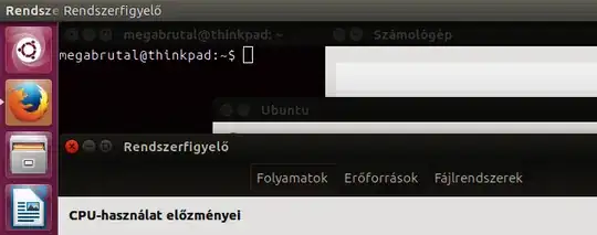

Since then, my applications are rendered darker than usual for no apparent reason. Not all applications are affected. For example, Firefox, LibreOffice are not affected. GNOME Terminal, System Monitor, Calculator, GEdit are affected, however. The pattern I see here is that GNOME applications are affected, though I'm not sure if this is the key.
Darker applications
See the attached screenshot. It is well visible that my applications are rendered darker than other desktop components: the Unity taskbar and the global title bar are rendered with their normal brightness, while the applications are noticeably darker. The purple background of the GNOME Terminal is almost like black. What might be the reason and how could I fix it?

Similar problem was solved for me with a full-upgrade. Some mesa related libraries, adapta-gtk-theme and xserver-xorg-core were updated with some additional libraries.
