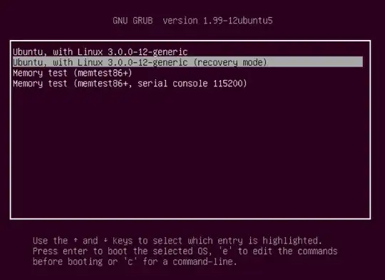

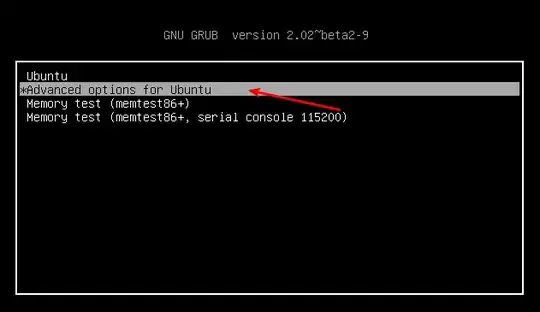

Boot up the machine, and after the BIOS screen, hold down the left Shift key (note that for UEFI BIOS you might need press ESC instead). You will then be prompted by a menu that looks something like this:
I've noticed on some systems that timing when to hit the left Shift key can be tricky, sometimes I miss it and need to try it again.
Hit the down arrow until you select the 2nd entry from the top (the one with the recovery mode in the description) and then hit Enter.

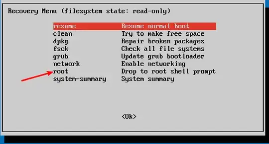

Now you should see this menu:
Using the arrow keys scroll down to root and then hit Enter.
You should now see a root prompt, something like this:

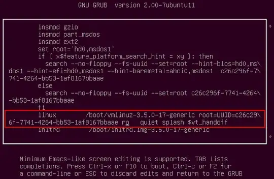

If you forgot the password for your Ubuntu system you can recover using the following steps:
  1. Turn your computer on.
  2. Press ESC at the GRUB prompt.
  3. Press e for edit.
  4. Highlight the line that begins kernel ......... or linux ........, press e
  5. Go to the very end of the line and add rw init=/bin/bash
  6. Press Enter, then press b to boot your system. Your system will boot up to a passwordless root shell.1
  7. Now issue the command passwd username *where "username" is the user for which you want to change the password.

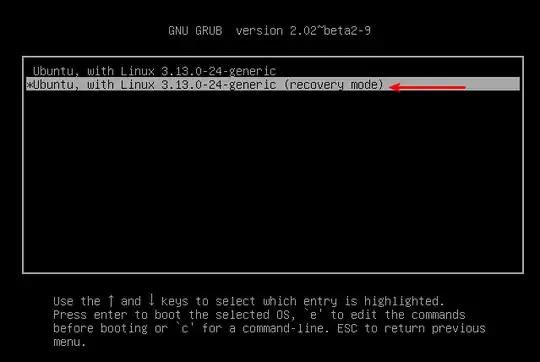

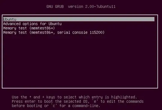

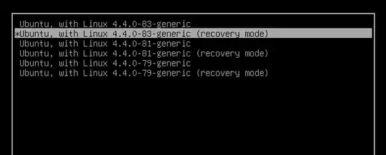

For Xubuntu 14.04 just follow the screens below. It's similar to some of the other answers.
Press Esc, and choose Advanced options
Enter image description here
Choose recovery mode:
Then choose root, and once you get the prompt type passwd <user_name>, to change the password.

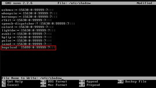

Then edit the password shadow file to remove the encrypted password for your username. Type in:
nano -B /etc/shadow
The nano editor will display the contents of the file. Each line will have the form name:⋯:⋯:⋯… where ⋯ is a string or null (empty). One of the lines will start with your username. The first ⋯ after your username is your encrypted password. As an example:
username:$1$amFeNcjp$PprjCKEVk3UtzKwWfEMOY0:14920:0:99999:7:::
where $1$amFeNcjp$PprjCKEVk3UtzKwWfEMOY0 is the encrypted password.
Carefully delete the encrypted password leaving the all the ":"s, so it looks like this:
username::14920:0:99999:7:::
Then type Ctrl+O, press the Enter key to save, then Ctrl+X to close nano.
Reboot and you will have an empty (or null) password. Be sure to use passwd username in a terminal to set or reset your user password.

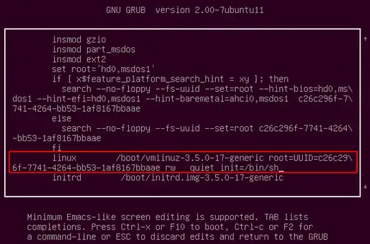

From the official Ubuntu LostPassword documentation:
  1. Reboot your computer
  2. Hold Shift during boot to start GRUB menu
  3. Highlight your image and press E to edit
  4. Find the line starting with "linux" and append rw init=/bin/bash at the end of that line
  5. Press Ctrl+X to boot.
  6. Type in passwd username
  7. Set your password.
  8. Type in reboot. If that doesn't work, hit Ctrl+Alt+Del

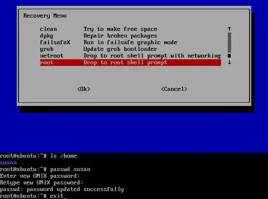

First, you have to reboot into recovery mode.
If you have a single-boot (Ubuntu is the only operating system on your computer), to get the boot menu to show, you have to hold down the Shift key during bootup. enter image description here From the boot menu, select recovery mode, which is usually the second boot option. enter image description here After you select recovery mode and wait for all the boot-up processes to finish, you'll be presented with a few options. In this case, you want the Drop to root shell prompt option so press the Down arrow to get to that option, and then press Enter to select it.
The root account is the ultimate administrator and can do anything to the Ubuntu installation (including erase it), so please be careful with what commands you enter in the root terminal.
Once you're at the root shell prompt, if you have forgotten your username as well, type
ls /home
That's a lowercase L, by the way, not a capital i, in ls. You should then see a list of the users on your Ubuntu installation. In this case, I'm going to reset Susan Brownmiller's password.
To reset the password, type
passwd username
where username is the username you want to reset. In this case, I want to reset Susan's password, so I type
passwd susan
You'll then be prompted for a new password. When you type the password you will get no visual response acknowledging your typing. Your password is still being accepted. Just type the password and hit Enter when you're done. You'll be prompted to retype the password. Do so and hit Enter again.
Now the password should be reset.

Then I got the Recovery Menu - but when I chose Drop to Root Shell Prompt (bottom item) I was root but couldn't reset the password - because the disks were Read Only. Type exit and get back to the Recovery Menu
There was a choice (not shown on Jorge's screen shot) to Remount Read/Write Used the down arrow to go to it, then left arrow to get to and Enter - and it mounted the disk RW.
Then again to Drop to Root Shell Prompt and I'm root and can write - so passwd username had me enter the desired password twice - then exit to go back to Recovery Menu Resume normal boot and everything worked fine with my new password! I'm the only account on this box, and my password works with sudo so I apparently have Administrative Privileges.

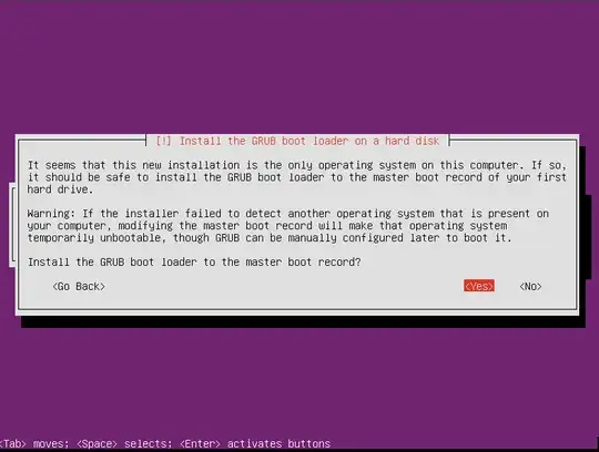

I was having the same problem with my password and I tried everyone's suggestions but none worked for me. So I tried some of my own and this is what worked for me... "Keep in mind I can NOT explain why it worked, all I know is it worked...
"10 Easy and Simple steps to Reset Lost or Forgotten Password"
  1. Reboot computer and hold the Left Shift Key down.
  2. Select boot into recovery mode.
  1. After a few seconds you should get the "Recovery Mode Options" screen.
Note: (Here is the part I can't explain. After trying everything, and nothing working, I finally just started trying all the options here one at a time. When I tried the "grub Update grub boot loader" and then followed the rest of the steps all was well and password was reset.)
So before going to the "root Drop to root shell promt"selection,
  1. Select "grub Update grub boot loader", and you should get this screen.
  1. Select "Yes". Wait for it to go through the update.
  2. Now select "root Drop to root shell prompt".
  3. Now you should be at a root terminal with something like the following: youracctname@yourcompname:~$. type passwd accountname ( acountname being the name of the account you are trying to change the password for ).
  4. Enter new Unix password: "enter the new password".
  5. Retype new Unix password: "retype the same password you did in Step-8".
  6. It should confirm successful password change. type exit at the prompt and reboot.
If this does not work for you, try skipping Steps 4 & 5...

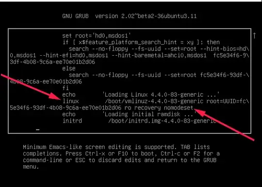

For me, on Ubuntu 16.04 VM installed in VirtualBox, when I boot into (with shift held before booting the VM) the root prompt, I always get Give root password for maintenance (or type Control-D to continue), finally I hit e at the GRUB menu with the newest recovery kernel selected in Advanced Options for Ubuntu
Advanced Options for Ubuntu in GRUB menu (kernels list)
and the hit Down scroll to the bottom, and see a line
linux /boot/...  ro recovery nomodeset
I scrolled to this line with Down/Up arrows, and moved to the end of this line of end, and changed ro recovery nomodeset to rw init=/bin/bash, and then hit Ctrl + x.
This will boot you into the system as root, and you can change your password as normal.

  1. Boot using live USB
  2. sudo mount /dev/sdb1 /mnt
  3. sudo nano -B /mnt/etc/shadow
  4. remove the encrypted pwd following the user who's password you want to set it to
  5. Save the file and quit nano
  6. Reboot from HDD
  7. login with the user who's password was set to
  8. passwd <user who's password was set to empty>
Go to beach!
In the boot GRUB menu, you may append init=/bin/bash to the kernel boot parameter to get a root shell.

Step 1: Go to Safe mode by holding Shift or pressing Escape key while booting
Step 2: Press E to edit command
Step 3: Search for "linux" and change ro to rw (It should be at bottom)
Step 4: Add init=/bin/sh at end of current line
Step 5: Press Ctrl + X to Reboot
You might need to remove splash $vt_handoff if present.
Now you should get a CLI shell
type nano /etc/shadow
remove all value from $ to : of the account you want to access.
Save the file and then reboot.
You should be able Log in without password.
