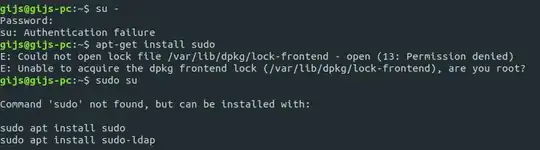

I need to use sudo but when I try to use it, a prompt tells me the command is not found and I need to install sudo.
So when I switch to su so I can gain root access to install sudo, it says auth failure
How can I fix this?
