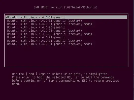

Fortunately you appear to have mastered the (IMHO) trickiest part - which is hitting the SHIFT at the right time to get into the grub menu:
grub menu
At that point, instead of choosing Ubuntu, with Linux X.Y.Z-NM-generic (recovery mode), press the e key. You should see a screen like

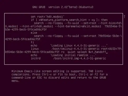

Use the (down arrow) key to scroll through the box until you find a line that starts with
linux /boot/vmlinuz-X.Y.Z-NM-generic
and ends something like
quiet splash $vt_handoff
grub edit boot entry

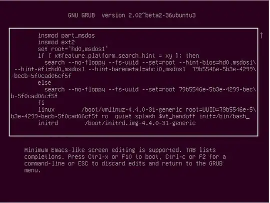

and position your cursor at the end - it may appear split over two lines using a \ at the end as seen here, but it's really one line. Then add the following
init=/bin/bash
(after a SPACE) so that it becomes
grub init shell
Now exit the grub screen by hitting CTRL+X
You should now be in a root shell just as though you'd entered recovery mode with either no or a valid root password. From here on in, the reset instructions are exactly as before i.e.
