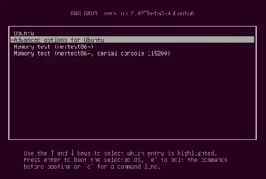

Don't worry. You will need to reset your password. First restart your PC, wait for the GRUB menu to appear(similar to this)grub menu
Now, from the list, select the Advanced option for Ubuntu and click Enter There will be two options, select the option to go to recovery mode.
Now you will be present with different options of recovery mode. Now you have to choose Root Drop into root shell prompt
