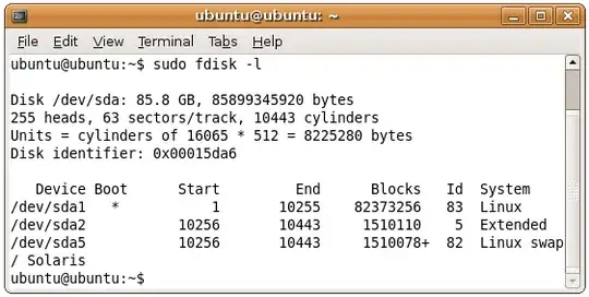

sudo fdisk -l
This command is used to tell what device name the hard drive is using, which in most cases should be /dev/sda1, but could be different on your system. enter image description here
