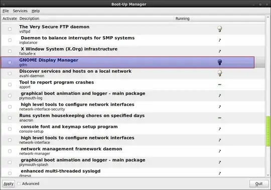

To disable GDM:
Install bum Install bum.
After installation it will be found under System>>Administration>>Bootup-Manager
Uncheck Gnome Display Manager alt text

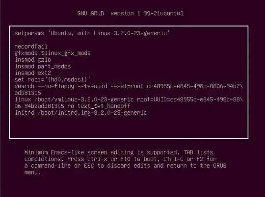

Yes, telling the system to start in console at boot time is possible through editing grub command. When you reach grub menu, highlight Ubuntu's entry and press e.
You will see text such as in the image bellow:
Change the text quiet splash to text . Press F10 to launch. (Source: rolling-ubuntu). I have tested this on my system, 14.04, booted into text console, no lightdm in sight. Started lightdm with sudo initctl start lightdm
To avoid doing so every time, you can add permanent grub entry with such option as suggested in this answer
