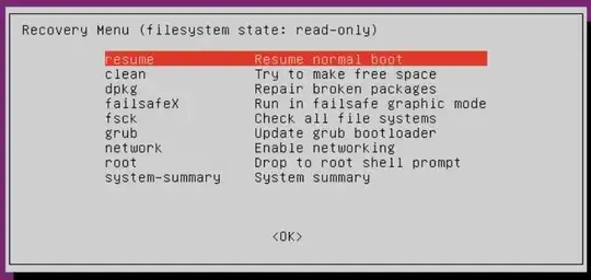

From the instructions I've seen, this is where I should see a "passwordless root shell" or perhaps a Recovery Menu screen such as the one below that I copied from the accepted answer in the link. But I never see either of these.

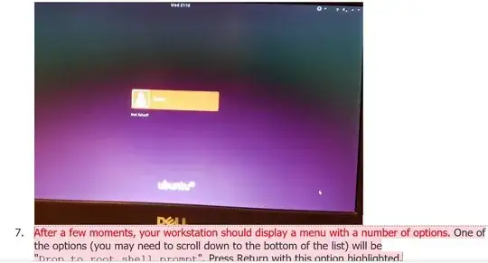

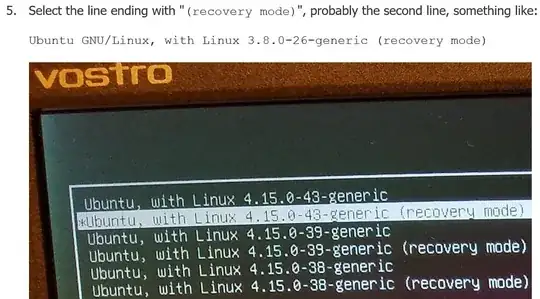

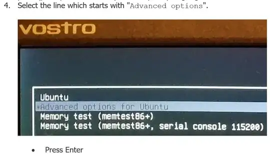

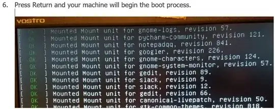

My screenshots of steps 4 thru 7 following the checklist at https://wiki.ubuntu.com/RecoveryMode. As in my previous attempts, the boot process does not take me to the promised shell prompt to reset the password but instead completes on the Ubuntu log in GUI page.
Step 4 enter image description here
Step 5 enter image description here
Step 6 enter image description here Boot process scrolls up the window...
And ends with Ubuntu launched and ready for user log in: enter image description here
Step 7 is never reached.

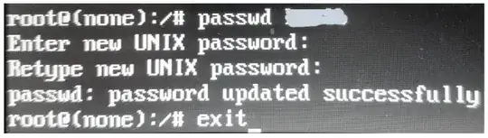

But I'm at a new prompt so I figure what the heck, let's try "passwd".
I enter "passwd my_user_name" and press Enter.
And lo and behold, I am prompted for my new password. I enter it, reenter it, and joy of joys, there's a message of success.
Back at a new "(none)" prompt, I type exit and hit Enter. From some checklists I tried, this is supposed to take me back to the Recovery Menu, but since I didn't see that screen on the way in it's probably asking too much to be taken "back" to it now :)

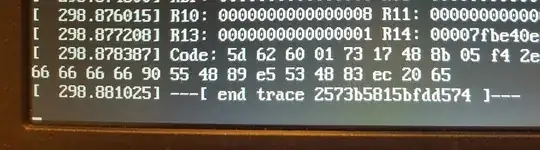

The boot process picks up for a few seconds, then gets hung up here:
After waiting a while, with no options I do a hard power down, figuring it's 50/50 if my new password survives.

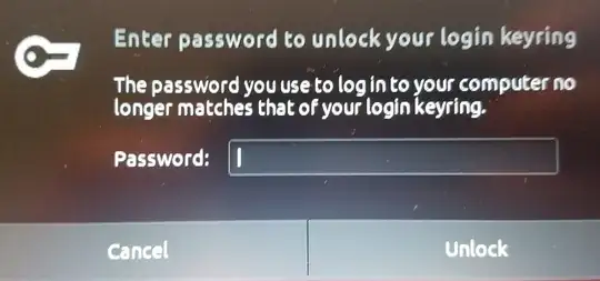

This immovable modal pops up: "Enter password to unlock your login keyring. The password you use to log in to your computer no longer matches ...."
Have I gotten this far only to be denied? I try my new password but of course it is not correct. I try a few more but of course they fail as well, b/c I don't know my old password! Now what?
And then I see it. A Cancel button, right there in the dialog box. I press it and voila, I'm in! Later I'll look into what the "login keyring" is, but for now I'll consider that the password issue is fixed. Hope this helps someone else out there!
