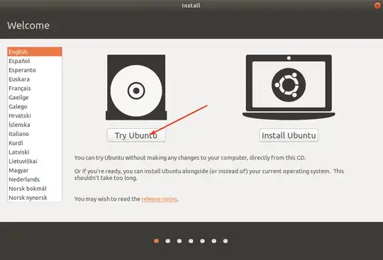

Since you have physical access to the machine you can do this via an Live USB/CD.
  1. Boot from your USB and chose 'Try Ubuntu' instead of 'Install Ubuntu'.
