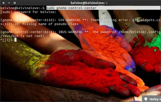

Use sudo. Press Ctrl+Alt+T and type in sudo gnome-control-center to open Ubuntu settings as a root user. Type in your current password when prompted
Opening Settings in Sudo mode
