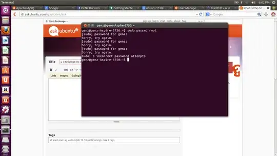

what is the default password of the sudo??, i visit some forums, it tells that the default password is password, but it doesn't work, how can i determine the password??
What is the default password of the sudo? I visit some forums, it tells that the default password is password, but it doesn't work, how can I determine the password?

There is no default password for sudo. The password that is being asked, is the same password that you set when you installed Ubuntu - the one you use to login.

Sudo is asking for the user's password it's called with. In your case the password in question is the password of the user genz, hence it says [sudo] password for genz:
