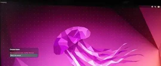

The unexpected result is that I am now locked out of my system, being unable to enter my password. The irony of the situation is that I do not know what I type.
The top right icons say "fr" but I probably screwed up this keyboard layout. I tried to pretend I was using an English QWERTY keyboard instead of French AZERTY but that failed miserably.

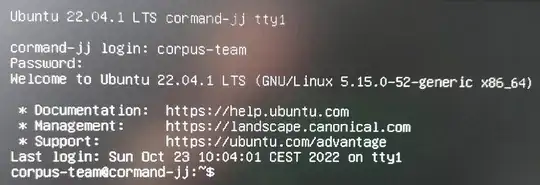

Here, fortunately I could see what I type in entering the user name (password is still hidden) - and - surprise! - the keyboard works just fine ! French AZERTY as it should have been.
I could enter no problem, restore my two my evdev files from backup. Upon reboot alas! this did not solve the password problem.

I have noticed that I can toggle between the login screen and the tty, using CTRL+ALT+F1 and CTRL+ALT+F7 login screen
However, so far, I have been unable to fix the keyboard layout issue on the login screen, although my password is OK on the tty interface, and although I have been able to change it to 12345678, which I though would avoid keyboard layout issues on the login screen, but no...
My last attempt following How do I change the login manager's keyboard layout? was around Mark Kirby's post : dpkg-reconfigure keyboard-configuration
When I changed over from French to English keyboard, that worked OK in the tty interface. Clumsy but I can manage: I know my Qwerty keyboard on an Azerty one...
However, back to the login screen, it still displays "Fr" in the top right corner of the screen... This does not solve my issue with the keyboard layout on the login screen.

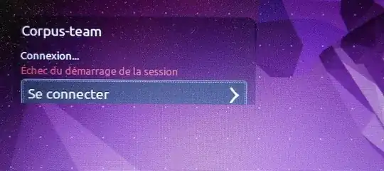

All of this failed miserably. I am no longer asked for a password, I now have instead the option to "connect", but it fails to open the session.
failed to open session

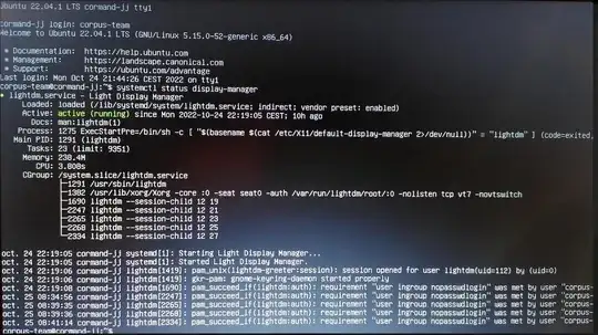

At this step, in tty, typing "systemlctl status display-manager" shows what happens when I click on "connect" but does not give a clue on the "session start" problem: display-manager status
