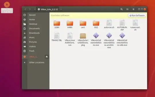

To install the Guest Additions we will have a CD icon on our desktop as soon as the virtual drive is mounted:
Next step is to run the autorun.sh script (as root) on this mounted CD by opening the drive and clicking on the "Run Software" button. This will build and install the vbox kernel modules needed.

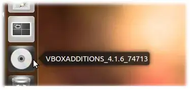

Unity
The guest additions is mounted as a virtual CD visible on the launcher:

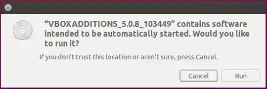

In case the system is set up to autorun a CD it should just open the following autorun dialogue (if not select the CD symbol, choose open, then choose Open Autorun Prompt)

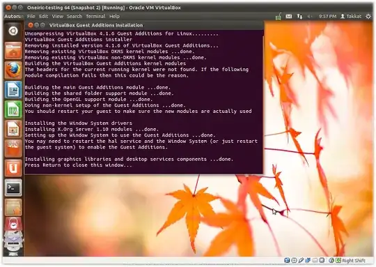

After having entered your credentials for root access the guest additions will build as seen from the terminal output:
Press Return to close the terminal.

The procedure is quite simple.
In Virtual Box menu select Devices > Insert Guest Additions CD Image....
The following popup will appear on your Ubuntu desktop :
guest addition popup
Select Run and Guest Additions will automatically be installed.
