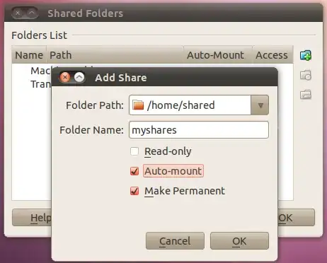

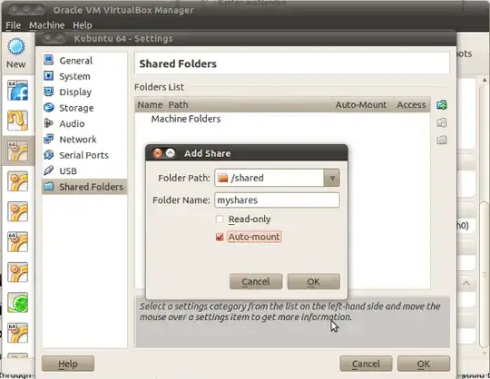

Right click on your virtual machine and choose Settings->Shared Folders. This will list existing shares or lets you define a new shared folde by clicking on the blue folder icon with the green +-sign on the top right side:
Choose your folder from the dropdown menu Folder path or choose Define other for a file selector that lists the host filesystem. Choose a name for the share (e.g. myshares). By ticking Auto-mount this folder will always be mounted in the Ubuntu guest directory /media/sf_myshares (the prefix sf_ will automatically be added).
Alternatively, to define shared folders in a running guest OS we may select Devices -> Shared Folders from the window menu of Virtual Box Manager:
By ticking Make Permanent these shared folders will also be available on the next boot and will be mounted when Auto-mount is ticked in addition.
