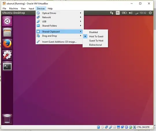

124
Go to VirtualMachine's Settings->General->Advanced->Shared Clipboard (Bidirectional)
Reboot your virtual machine.
for me it solved the problem (it was set on Disabled), I had some machines working some not, so i checked settings in working ones they had bidirectional clipboard. Dont know if this was upgrade issue or... just double check your shared clipboard options.
Hope this helps someone.

In VirtualBox 4.x:
Start the Ubuntu instance, then in the VirtualBox menu at the top of the running instance window, Machine > Settings..., Advanced tab, change Clipboard Sharing to Bidirectional. It's set to Disabled by default.

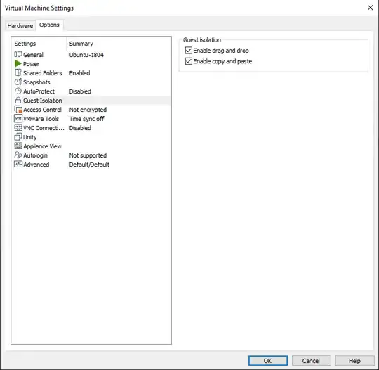

For VMWare 15, I had to pause / shutdown the machine and go to VM -> Settings -> Options tab -> Guest Isolation
From there you can check / uncheck Enable copy and pasteenter image description here
