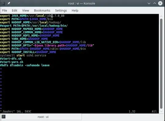

Here is how I resolved the issue. I had installed Hadoop on my guest openSuse OS. There are several services which need to be started to start working on Hadoop like:
start-dfs.sh
start-yarn.sh
I added both the above start commands in my .bashrc file so that I don't have to start them explicitly every time I log in. .bashrc gets executed every time I log in.
cd ~
vi .bashrc
I commented my start service commands as shown below.
.bashrc file open in Vim
Zanna
  • 72,312
