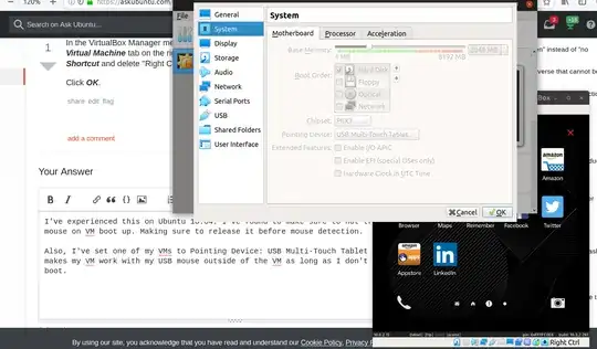

I've experienced this on Ubuntu 18.04. I've found to make sure to not trap the mouse on VM boot up. Making sure to release it before mouse detection.
Also, I've set one of my VMs to Pointing Device: USB Multi-Touch Tablet and it makes my VM work with my USB mouse outside of the VM as long as I don't trap it on boot.
