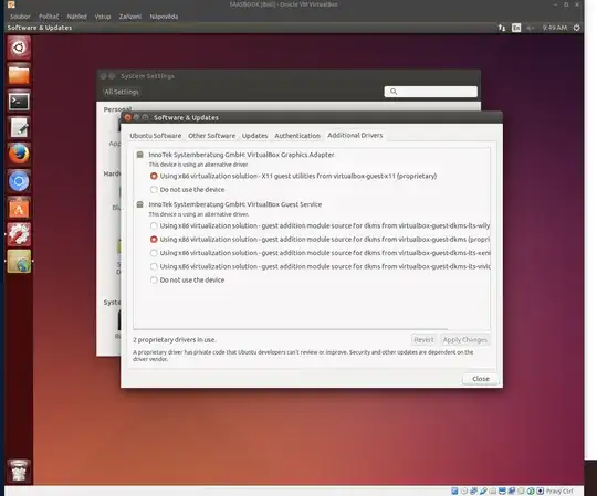

I did this setting and all was OK:
Additional drivers

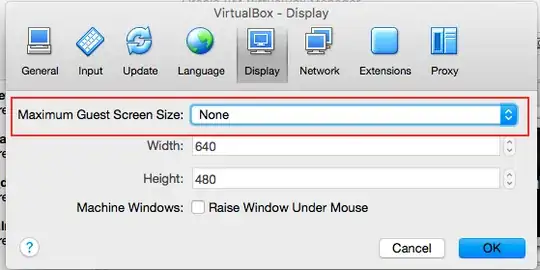

If none of the answers helps you fixing the issue (like it was situation with me), then verify on your Host OS that in "Screen resolution" window (Control Panel > Appearance and Personalization > Display) whether the displays are aligned and not like in picture from the following link:
Preview of settings on Host OS that caused me issue with maximum resolution on Guest OS
If someone is confused because of the value of shown Display field, the reason is that I don't use Windows 7 as my Host OS, so I've used it on VirtualBox in order to simulate problem.
If you would like to use different resolution on each monitor and/or you are not sure how to align displays in previous window, clicking on "Detect" button should do things properly for you. You probably wouldn't suspect that that causes problem because, if you use Windows 7 (or any newer versions of Windows) as Host OS, it will successfully render image on your monitors, even when the set positioning is distorted as shown.

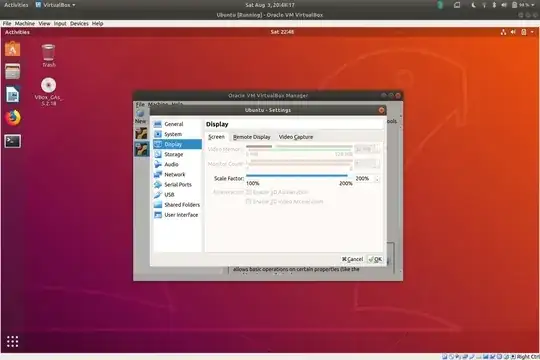

The scale factor in the virtual machine settings did the trick for me. I set it from 100% to 200%.
Note: I have a Huawei Matebook X Pro.

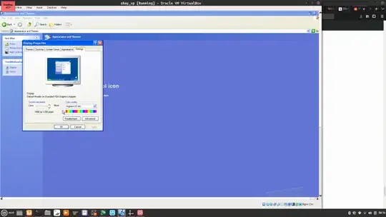

All I had to do was go into the guest OS's display settings and change it to maximum resolution. (Make sure in the VirtualBox settings that you don't have it set to a maximum width of about 600px).
View image here
