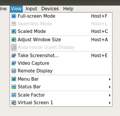

Edit Aug 22, 2018 -- you may also have to twiddle with the Adjust Windows Size and Auto-resize Guest Display items on the VirtualBox View app menu to get resize working correctly.
VirtualBox "View" menu

For me , I couldn't get the Linux Mint window to display crystal clear without having the scrollbars showing lost screen space. When I selected the resize in the top right (2 square boxes that resize windows) to get everything to fit, the fonts on the screen turned fuzzy.
The answer was to select View > Full Screen Mode from the top menu after I got the warning box on startup about the switch mode. This puts a small hidden VBox menu at the top of the screen which is perfect. You can see "Full Screen Mode" on the picture of the menu in one of the posts above.
