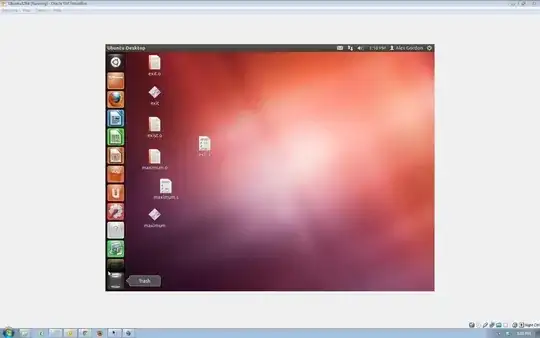

I am VirtualBox on windows 7.
The VM has Ubuntu32bit (latest version) running.
I am unable to maximimze the Ubuntu window.
Here's a screen shot of what I see:
Please, please go easy on me! I'm a microsoft guy, and JUST started with linux.
Agmenor
  • 16,394
As fossfreedom indicates in a comment, it is better to install the Virtualox Guest Additions first. See this question to do so: How do I install Guest Additions in a VirtualBox VM?.
After that, if you still have your problem, try changing the resolution of Ubuntu inside Ubuntu:
  • Go to the Dash Menu (the big Ubuntu button in the top-left corner).
  • Then type "Resolution" or "Displays" to see the "Displays" app.
  • Launch it by clicking on it.
  • You should then be able to augment the resolution.
Agmenor
  • 16,394
here's what worked!!
sudo apt-get install virtualbox-ose-guest-utils virtualbox-ose-guest-x11 virtualbox-ose-guest-dkms
