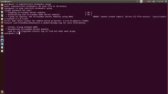

After this I followed on terminal and ran this command after which I got this result
please help as I am new to ubuntu and not very open with command system please let me know whats the problem. thanks in advance .....I need to run my windows 7 professional over virtual box

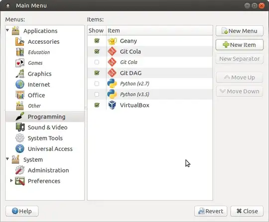

Finally, add a Virtualbox menu item with this superb tool that only Ubuntu Mate offers(!)-the all mighty alacarte command of previous decade and broken in newer versions of Ubuntu!: System->Preferences->Look and Feel->Main Menu enter image description here

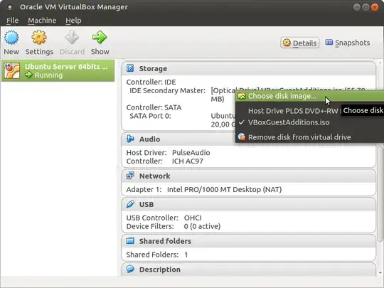

  1. on Virtual Box Manager (main window) select the just copied file enter image description here
In the picture it's obvious that I already did it!
